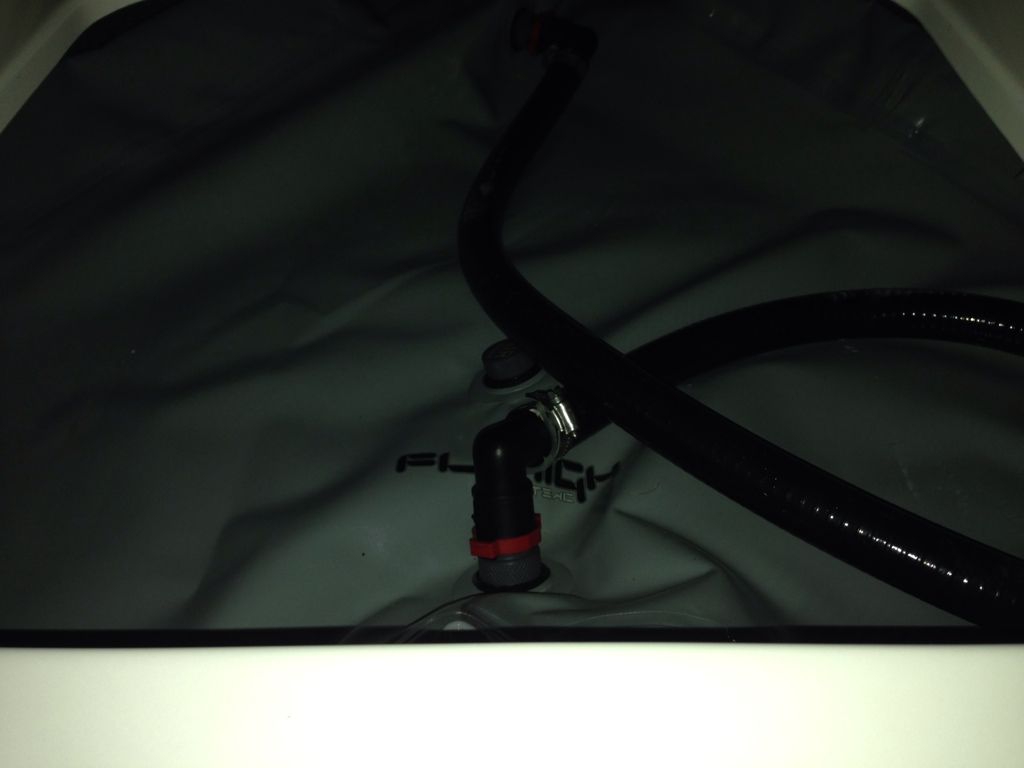

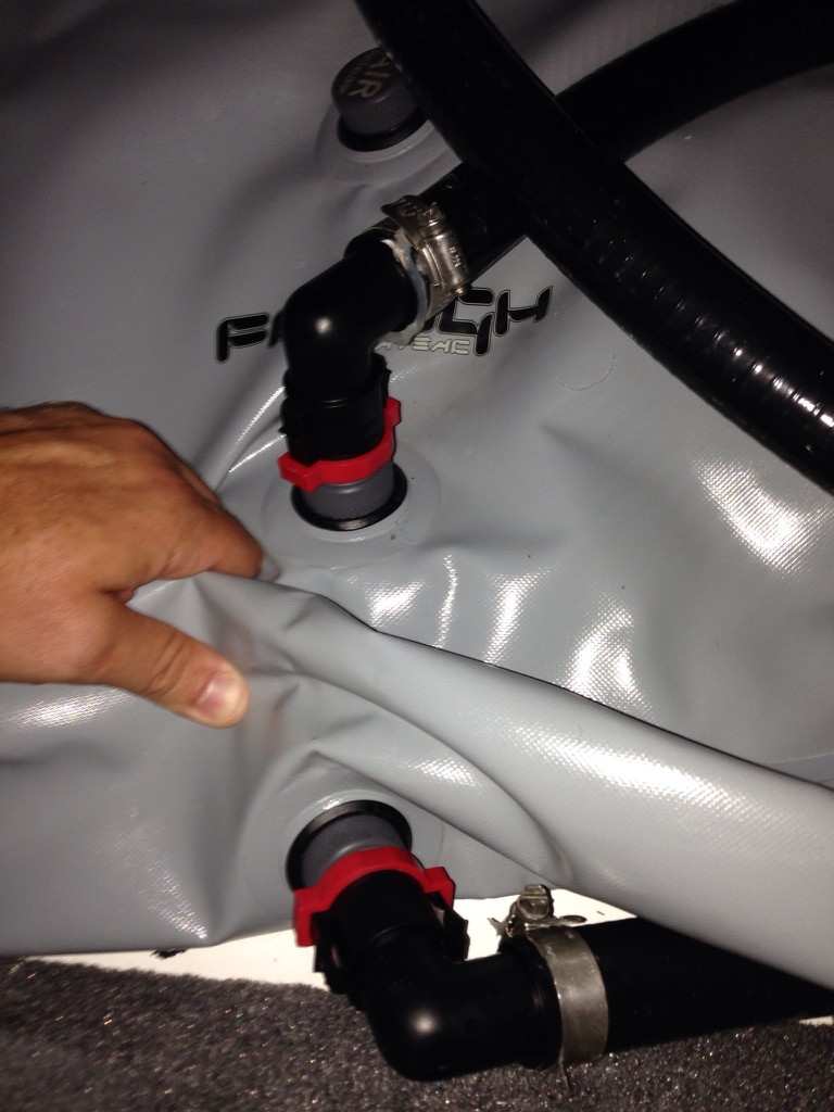

If I get a pic of mine, showing what direction each tube goes, would that be helpful? Let me know if so and I'll hop in there and take one..
Not sure if this actually helps or not. Hopefully.
