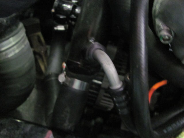

It's behind the driver side panel just below the trans cooler
