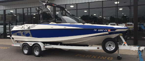

I just purchased a 09 A22 and wanted to get peoples thoughts on what to upgrade first? Also what i should look out for...The boat will be manily used for surfing and family fun.

What do you mean what to upgrade first? Do you want a crazy stereo, some ballast help, info on surf wave suction setups etc. What engine and prop do you have etc.

If you’re surfing, you want 1100lb sacs in the rear and a mission delta surf device. Probably want a 15x12 prop too.
Run the boat with passengers sitting on the surf side and all ballast full at 10.8 mph.

Boat looks great, congrats!
Upgrades I'd suggest:
Update reg numbers with domednumbers.com
Consider a seat riser if you are surfing a lot
Add a heater if not equipped to keep the kiddos happy on chilly days
GatorStep flooring and gunnel kit

Start with the surf wake.. Get that dialed in.
Does it have bags? You need rears and a front bag.
Get a shaper.
check your prop and make sure it has some low end.
