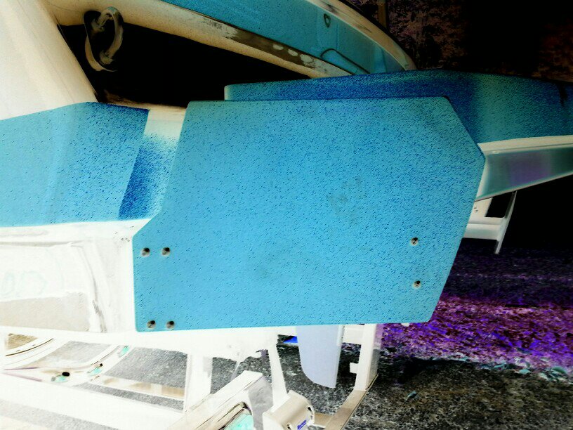

Negative

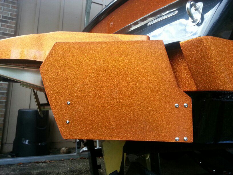

PostPosted: Sun Oct 13, 2013 7:27 am
Starboard

It is difficult to get a good one of the portside because of light. I will take another pic later today.

Thanks! That will work just fine. Later today Ill; transfer the measurements, cleanup the image , and scale it to actual size to make a good template. Since most folks dont have a large format printer, Ill split is up across 4 pages and add alignment dots.
