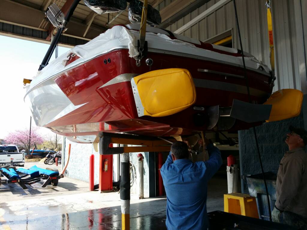

This was mine at the factory.
[attachment=-1]uploadfromtaptalk1400875985599.jpg[/attachment]
2014 Axis T22

Well I'll be.......that would account for the direction of movement of the d-rings shown in my photos. If that's common practice at the factory then something else contributed to the gelcoat damage since not every boat is damaged. Oversized holes, insufficient torque on the d-ring nuts or a combination of the two. Disappointing anyways. Sent off an email to the dealer I purchased the boat from but not word back yet.
Nice T22. Have any issues with it similar to mine?

Yes. Every boat is lifted that way. They water test every boat and that was mine getting the prop put on. I was actually allowed to walk under it and I was asking questions about the different ports on the bottom. Other than the stitching on the upholstery that everyone seems to have problems with...no. There were supposedly a couple of spots on the gelcoat that my dealer had the factory fix before I took delivery. I guess that's a benefit of living close to the factory.

I'd be Fing burnt!!! They actually delivered the boat to you with the d rings looking like that???? If that's the case I would have a call into axis corporate.
with that said I noticed you did say it was a 2013. was this damage possibly done while being on the dealers lot? 2014 production started last July. If that damage was there from the factory id really have questions for my dealer.
