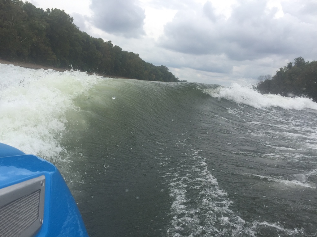

I have 16' with a 350. I run 1100's in the rear and full bow sac. All factory ballast full and a 400 in the walkway and another 400 in another in the cabin floor.1235 prop. I have no issues surfing.

Gibbs, how many adults as your crew? This could add up to what he's wanting.
 Post subject: Re: Engine options? T23
PostPosted: Wed Nov 11, 2015 8:30 am
3 adults
