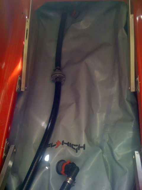

This weekend I'm going to switch the fill and vent hose locations, since the vent hose is under the fiberglass panel, I'm going to route it to the fill port where the air pocket usually is and see if that helps with venting out the big bubble that seems to get trapped under the chillax, we'll see how it goes, here's a pic after moving the hoses, I routed the vent to the rear and under the bag so that it doesn't kink and stop working properly, i'll let you guys know how everything works out

a check valve just like the one you see in the above picture^ will do the trick, if your boat is an '11 model it should have one but you can try moving it from right at the pump to the top of the bag so there is less water pressure pushing back on it

Darth- mines a 2011 and has the check valve just like in walters picture. I have had no problems with my front sack. I think its $12 at wakemakers.com

our is a 2010, and has NO check valve that I can see. will have to get one and install it. Which line does it go on? fill or drain line? which is which?
