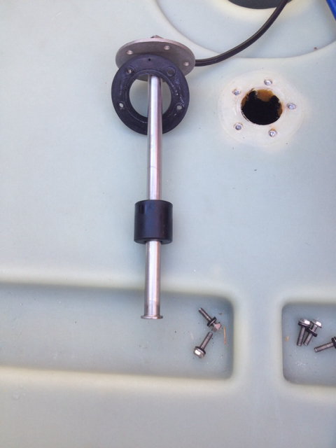

 Post subject: Fuel gauge
PostPosted: Wed Jun 11, 2014 6:56 pm
Posts: 59
Well since the thread was already here I guess I'll post it in here. So today after we were out on the water it showed a 3/4 tank of gas, after about 20 minutes it was showing empty. I knew it wasn't empty because just over a week ago I put 46 gallons of gas in the boat. So when I can home I took the fuel gauge indicator out, and did an ohm test with it and the needle barely moved but it moved. Has anyone else had any problems? I really don't like taking the boat to the dealer because they say 2 weeks but then in 2 weeks they say another 3 or 4 and it's kind of summer in California and having the boat at the dealer that long just isn't how I want to start the summer.
