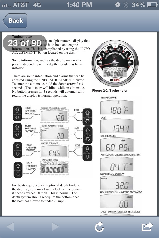

Ok did the whole get the boat up to speed hold button down and all the gauges seemed to re boot but would not let me calibrate the speed.

Make sure the info is on air temp

Air temp? I though the instructions were to have it on lake temp

Ya check out this link
viewtopic.php?t=1779
 Post subject: Re: Wakesurfing set up
PostPosted: Sat Jun 29, 2013 7:56 pm
