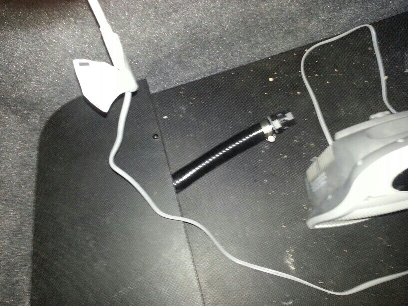

[attachment=-1]uploadfromtaptalk1395797705000.jpg[/attachment]
I have an elbow fitting. Will that much hose and an elbow fitting not get kinked when the bags are full? I got the 900lb sumos.
