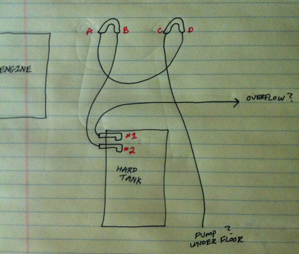

OK...., I have tried to follow the other post but got lost after the first few pages of replies. I have also watched a video and thought that I had it but when I got in the back of the boat I had a complete Brain Fart. I have attached a picture of my ballast system in the back of the boat. I used the right side for this diagram. I have labeled each hook-up and would like some break it down so that a 5th grader could understand it.
I think that I have to un-hook 'A' and hook it up to the top of my ballast bag...?
I think that I have to un-hook 'B' and t rim the excess and hook it to the bottom of my ballast bag...?
Is this correct...?
Any and all suggestions are appreciated.

Correct, that's the way it was designed to be hooked up, some do it different but that's the way mine is and it has always worked great
