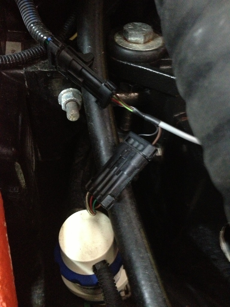

Check the connector for the transducer, right below the chillax seat on the port side, next to the thru-hull pump for the rear ballast, may have moisture in the connector causing problems. Here is a not so good pic I took when installing my GPS

Thanks for the image and suggestion Walter. I will take a look at this area tomorrow and report back on whether I'm able to get it fixed.

On the 2012, the paddle wheel only has a short cable, maybe 5 or 6 feet. It plugs into a harness on the port side of the engine. You may want to look there too.

Thanks for the suggestions guys. So when we got the boat on the water last weekend, the speedometer ended up working the entire time. It was off about 1mph from the reset that we did, so we fixed that and then assumed we would be good to go. What then started happening though is that the cruise control started surging. We had it set at 10.8 for surfing and as we would be going along, the actual speed on the digital gauge would drop to 5 or 6 all of a sudden even though the actual speed of the boat didn't change. That caused the boat to surge ahead because it thought that it needed to get back up to 10.8 even though we had never truly dropped in speed. The gauge was also beeping and the actual speed displayed would flash almost continually during a run. Initially it would do this several times per surf run, but then towards the end of the day it was doing it maybe once per run.
We opened up the area back by the engine as you suggested Walter. We found the speedometer unit which is made by a company called Airmar. It's basically just a tube with a wire going into it that then goes through the hull and it has the wheel on the bottom side of it. There were two screws on the top that I took off and that allowed me to take the cap off of the top of it, but it didn't really show me anything additional. There isn't any kind of a connector. The wire just goes down inside the tube and then the other end goes in toward the engine compartment. There was a small amount of water in the top of the tube when I took the cap off of the top. We left everything open and wiped up any water that we found in hopes that it would dry out during the week. I don't have high hopes that it will resolve things, but maybe we'll luck out.
I haven't followed the wire from the Airmar tube into the engine compartment yet. I will try that Saturday and see if I can find any kind of a connection that may be loose. I'm starting to think though that the wheel/tube part may be going bad. The wheel itself spins freely, so I don't know what else would really be in there that would go bad, but it sure seems to be something with that piece.
