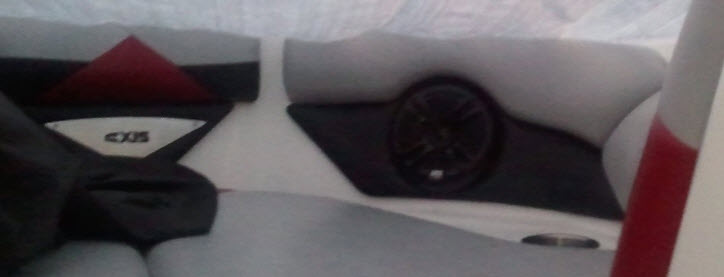

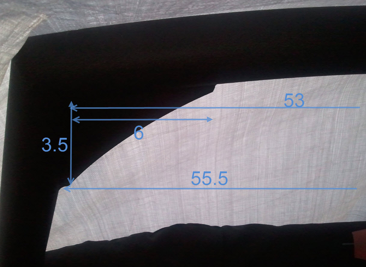

These dimensions are from an 09 and I'm not sure if the bow has changed enough to allow for larger speakers. In my case the speakers are 7".
The tower has 53" of space inside, but less for mounting due to the corner supports. When you drop below the corner tabs it increases to 55.5". The 3.5" dimension is measured vertically. The corner supports are 6".

Thanks a lot for the pics. I was hoping 2 pairs rev 10s and a 410 in the middle would fit but it won't :(
