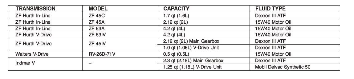

Not finding a lot of information surprisingly and stuck in jury duty....
Do the vdrive and transmission both use the same oil? Or does it depend on the vdrive? I have a 2013 A22, and with the season starting up I want to change these fluids out and haven't yet.
Thanks for any info. From what I understand I'll just use my oil pump to remove both fluids, but hoping to get them on my way home today.

Found it.
