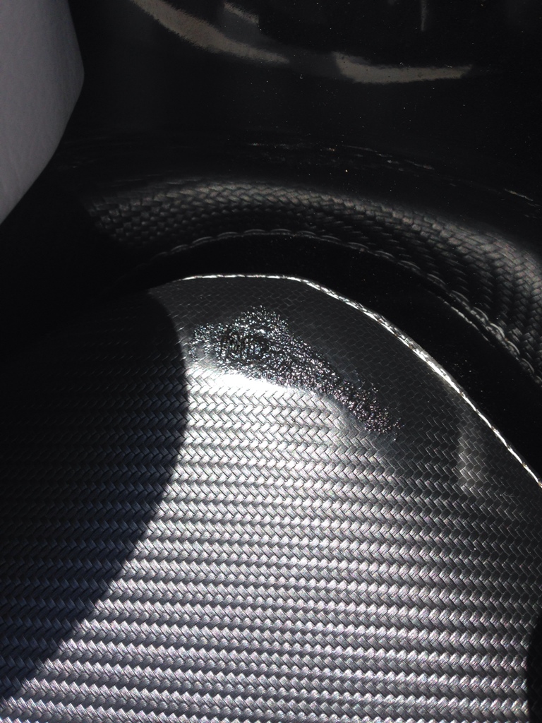

So have Black Boat with green flake paint, looks like parts of front cushions are melting.

Yes its a known issue axis replaced my front skins for free. The 14's have a piece of deck trac on the gel coat in the corner above that area.

Since your boat is black I would get some Seadek and stick them in those corners so the sun will not reflect or you can order some traction pads from Agenda Surf cheaper.
