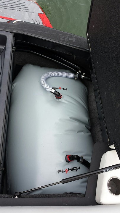

I'm not sure what boat u have but my t22 it's the front
You can find out by following the lines back to the loop, whichever one goes to the loop on the wall is the vent i believe
