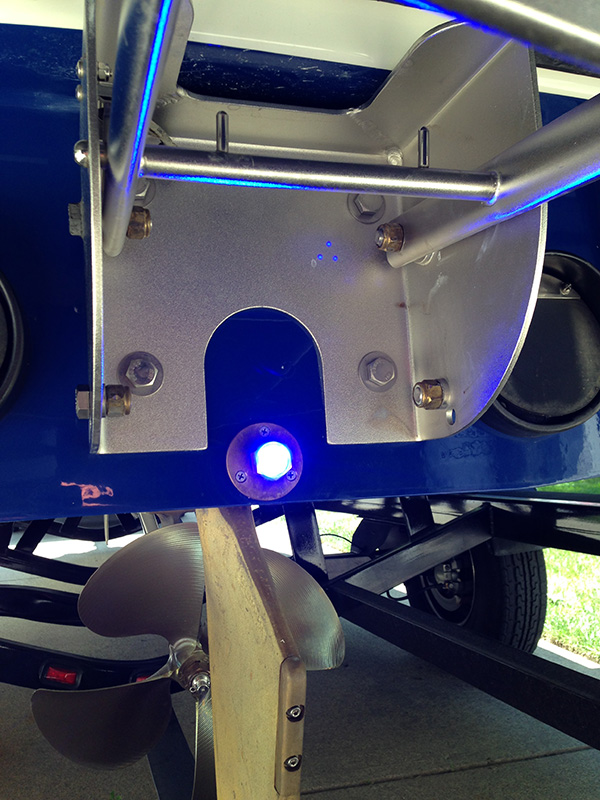

and for good measure, I threw this led drain plug in as well...35 bucks on ebay.
