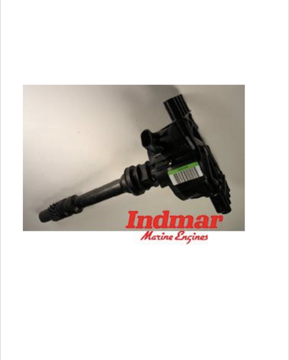

Joined: Mon Jun 24, 2019 9:55 pm
Posts: 3
Did you replace just the cap and rotor or the entire distributor? I have the same problem and was trying to figure out which to purchase.

Joined: Sat Feb 02, 2013 10:05 am
Posts: 20
I just replaced cap and rotor.
