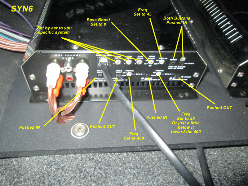

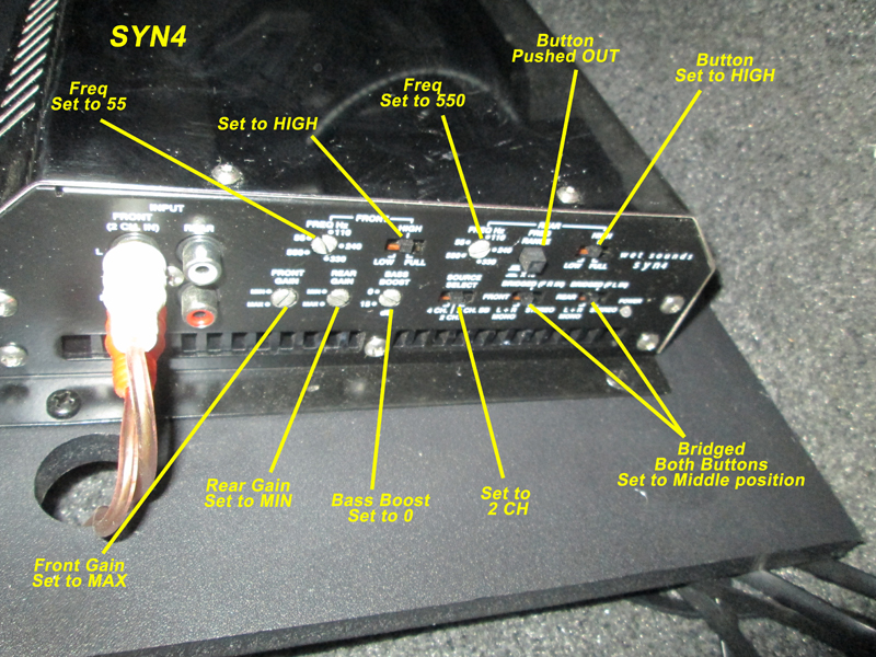

Anyone that has sound pack 3, Can you post up a picture of your amp settings? I had a 3 year old climb in the storage under the glove box and mess up all the dials and buttons on my syn 4 and syn 6. Much appreciation to anyone who can help me figure out where they were set before. Thanks in advance!

I have SP3 and this is how mine is set up.
Hope this helps.

Bama, that is exactly what I was hoping for. Thanks so much! Love this forum!!
 Post subject: Re: Help me fix my sound (sound pack 3)
PostPosted: Sat Oct 10, 2015 8:20 am
Keep in mind these are analog components so the best settings are going to vary from one system to the next. You can use Bama's settings to get close but best thing to do is follow the tuning procedure from the wetsounds website.

Thanks for the additional tip. I was able to get it close but it still sounds a bit funny. Can you link the tuning procedure? I didnt see it on the wetsounds site. Thanks for the help guys!

Here is the guide for tuning. If you don't have a WS-420 in your systems, just skip those steps. The rest still applies.
http://www.wetsounds.com/media/products ... lation.pdf
PostPosted: Thu Oct 22, 2015 11:47 am
Joined: Thu Jul 30, 2015 1:30 pm
Posts: 34
Location: Memphis TN
I followed that guide and it sounds like a dream now. Probably even better than before the "incident" happened. Thanks for everything.
