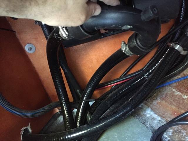

I had this same problem on my 2014 A20. There is an anti siphon valve behind the dash. I started have problems when the zip tie holding the valve up broke. This valve needs to be mounted as high as possible above the water line to work. I had to remove the sub enclosure to gain access. The valve looks like

Yes. It shouldn't take too long to fix. Remove the kick plate that holds the sub. Mine is black plastic. There are only a few screws. Leave the sub attached to the kick plate. Remove the two speaker wires that attach to the sub. Remove and you will have access under the dash. This is what mine looked like inside
As you can see the anti siphon valve was flopping around on the floor board
