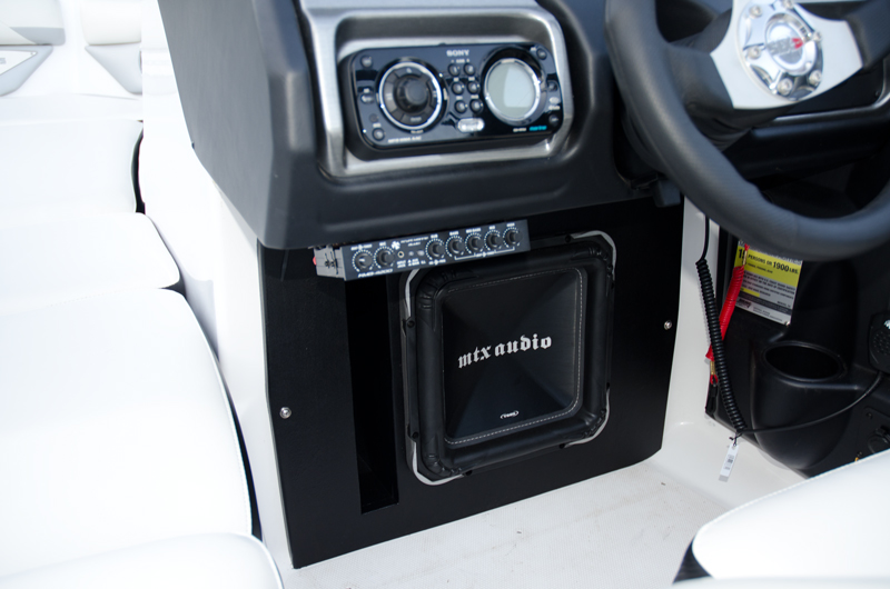

Here's the box I went with
I have yet to install it. Waiting till it cools down a bit outside.
