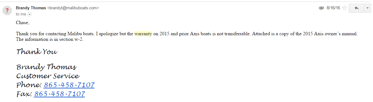

As far as warranty, see the attached email. Does not transfer.
2017-04-07 13_02_54-RE_ Axis Contact Us Request - chaserummans@gmail.com - Gmail.png
2017-04-07 13_02_54-RE_ Axis Contact Us Request - chaserummans@gmail.com - Gmail.png [ 26.34 KiB | Viewed 46233 times ]

So the Axis warranty from Malibu may not transfer, but the one from PCM regarding the Engine should. Malibu doesn't honor that, PCM does.
