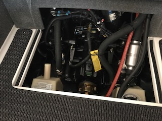

Can anyone tell me where I'm missing the second transmission / V drive fluid check at?
I can find the main engine oil just fine and the port for the transmission fluid fine (yellow dipstick behind the yellow label in the pic), but unlike all the other threads on fluid changes I dont see two dipsticks for the transmission/v-drive. I'm assuming I'm missing the v-drive dip stick or is it all one fill port now? Ive checked port and starboard engine access compartments and aint seeing a second dipstick anywhere. Dealer is fine with myself doing own service and maintaining warranty integrity so long as its documented. Going to take it to them for the 1st service shaft alignment check but plan on doing everything else myself. They didn't seem to keen on paying for the full service and watching the mechanics to learn from them. I also dont want to leave my boat for 2 weeks for a fluid change.
My manual calls for dexon III for Challenger transmissions(red) and Mobiltrans SHC 50 for Challenger V drive Transmissions (amber fluid). The dip stick I'm seeing looks like standard red atf. Of course there is no diagram of the motor or transmission in the manuals.
2017 T23 PCM Monsoon 409 / Pleasure craft power plus 1.73 gear ratio label on the transmission.
Thank in advance!

This should help
http://www.crusaderengines.com/challeng ... is/#owners

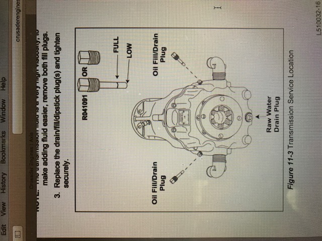

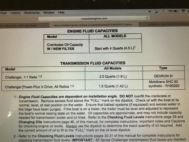

Don't know how I missed it in the 2017 manual but its clear in the 16 manual. Check at 25 hours and annually there after for the 17's. Only change if contamination is present per manual.

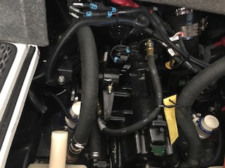

And fluid totals for those that this helps. the yellow dipstick is the regular transmission and the bolts that are there are in the pic above are for the vdrive.
