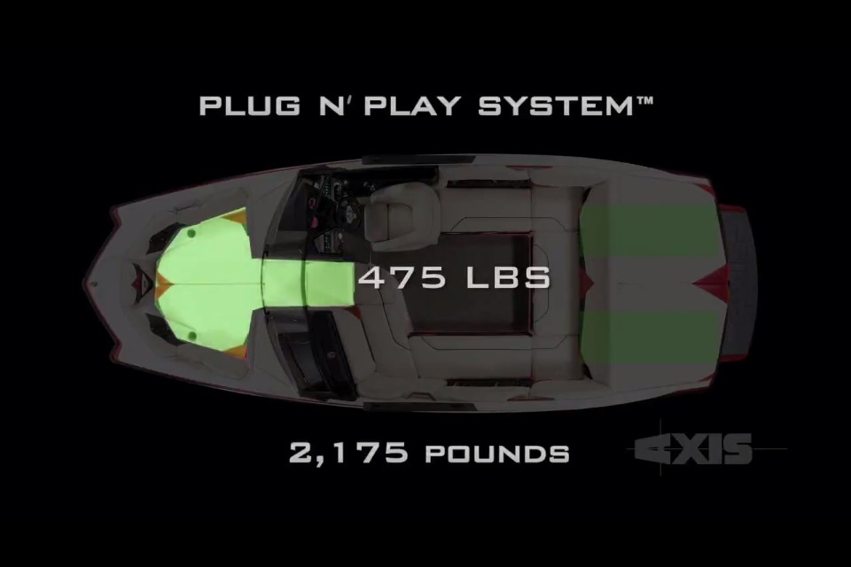

Right from the VP's mouth, it's 475 under the seat, the 900 or whatever people claim is if it's on top of the seat fully expanded, watch this video at 2:30
http://www.youtube.com/watch?v=I39vMHah ... ata_player
If you pay attention when filling the front bag and tank the bag vents shortly before the tank does
