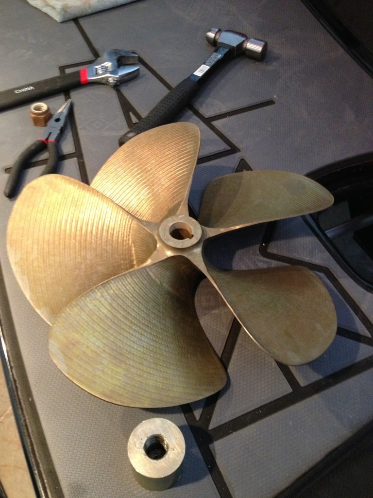

The reason I removed it is to use on my friends tige that we just finished replacing the underwater gear, a 14" prop is the biggest his boat can handle hence using the OJ instead of my 1235 or 1615
