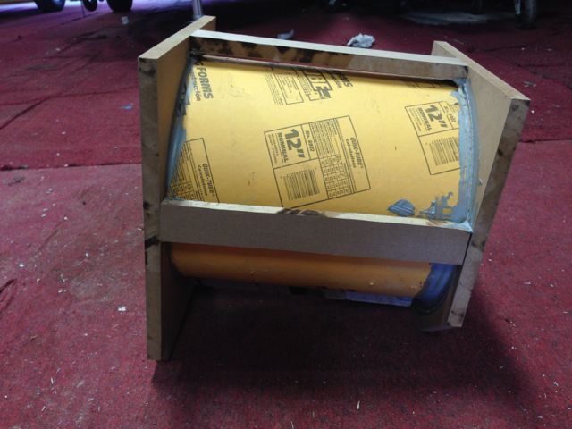

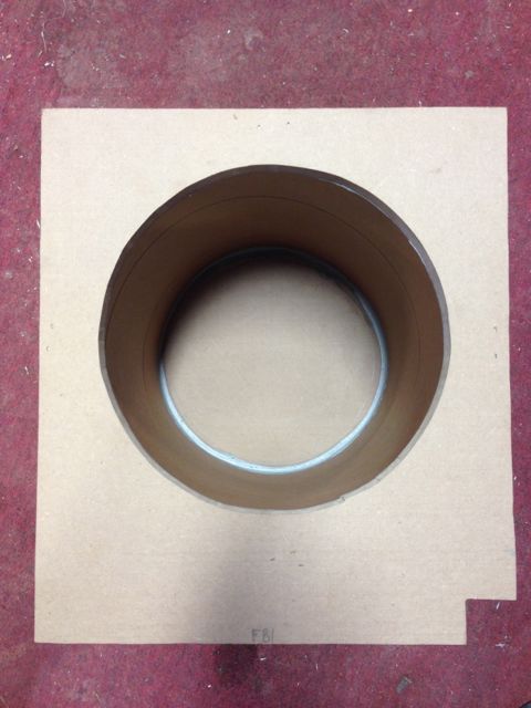

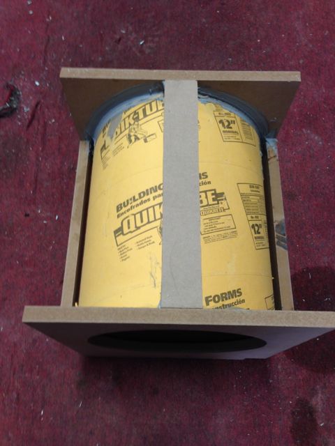

If you're not crazy about building a full box, you may find that using a 12" sonotube between two panels (3/4" MDF board) will work nicely for you. If you have a router you can recess the tube into a groove in the end panel prior to adding adhesive and sealant.
Here's one for a T22, before paint or undercoating.

So if my math is right that sonotube needs to be 17" long to = the recommended 1.1 cubic feet for a wetsounds XS12. I'll have to measure and see if that will fit under the dash of my A24 - I like that idea!
 Post subject: Re: Which Sub Woofer for 2014 Axis A20
PostPosted: Wed Apr 02, 2014 6:52 pm
Joined: Mon Sep 20, 2010 10:17 am
Posts: 32
Yes, 17" is good, and make sure you router a groove to slide the tube into for a good airtight seal.
