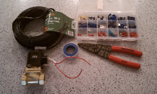

Cost: Approx $80

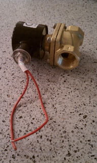

2 12v electronic brass valves 3/4", set at NORMALLY CLOSED (they only open when they have power to them)......delivered = $68 (photo 1)
1 50' section of 16g "lamp cord", low voltage wiring, at home depot = $8 (photo 6)
4 female electric connectors 12-10 guage = $4 (photo 4)
Everything else I already had. If your replacing manual valves, it is a lot faster, if starting from scratch, you will need more materials.

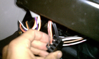

4. Locate ballast switch 8 pin connector housings from behind the dash (photo 5). Rear-Left ballast connector housing is the 3rd from the right. Rear-Right ballast connector housing is the 4th from the right (in the picture, this housing has been removed so all you can see is the back of the rocker switch and its 7 flat pin male connectors.)
5. Remove one ballast connector by pinching the housing with a finger on top and your thumb on the bottom. You will need to squeeze hard to release the clip on the thumb side of the housing. The housing has 8 slots (photo 9). Top right= 2 black wires, grounds for both fill and empty pumps. Left top = 1 brown wire, the power wire to the EMPTY pump. Below that is 1 red/orange power wire. Bottom left = 1 brown wire, the power wire to the FILL pump.

File comment: found these for $30 delivered on ebay. 3/4" normally CLOSED, brass, thread same as PVC 3/4" thread.

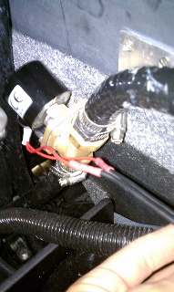

File comment: Electonic Valve in same location as manual valve. If I started from scratch I would put this behind the access panel in the lockers.

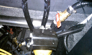

File comment: Manual Ball valve... had to lift both hatches and slide the dryer bin to access them, trying not to burn my hand when turning them.

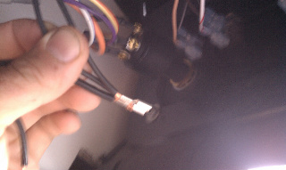

File comment: top is original, middle is new, bottom is new one with insulation removed so that it will fit in the hole of the housing

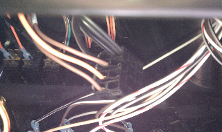

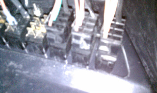

File comment: back side of ballast rocker switches. housing connection 4th from right (right rear ballast) has been disconnected.

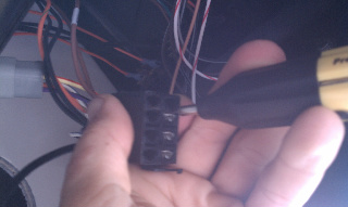

File comment: 2 pump ground wires and 1 valve wire connected to a new female pin connector. push this back into the hole in the housing it came from.
File comment: I used a long thin Slot screw driver in between the housing and the flat side of the female pin connector. I pushed it all the way in until I was able to get the connector to pull out the back
