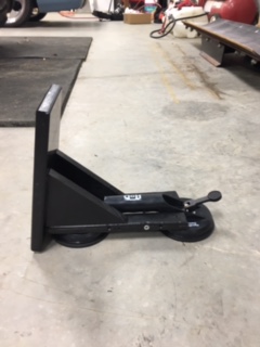

Made a homemade delta. I hope to try it out this weekend. Let me know what you think.

I'm thinking of doing the same. Is that one of the aluminum dent pullers from ebay?

It's plastic, but yes.

I found some at Harbor Freight for $8. Also found this thread last night - http://www.mastercraft.com/teamtalk/sho ... hp?t=70442. Lots of options and ideas starting about halfway through the thread.

Did you use 1/2" or 3/4" HDPE?

I used 3/4 cause that's what I had. Also the harbor freight suction cup is the way to go. The HOD Amazon is not strong enough

So you think 1/2" would work?

I do, yes.

To add some info to the thread... The amazon plastic cups fell off every 5 minutes for me. The amazon metal ones worked like a charm https://www.amazon.com/COSMOS-Aluminum- ... uction+cup
Used 1/2" HDPE off amazon. Two shelf brackets from lowes, http://www.lowes.com/pd/Style-Selection ... et/3455946 . The shelf brackets have holes predrilled and they line up with the middle of the suction cups (close).
TeamTalk has an extended thread on this. I cut my hdpe 9"x6" and rounded the outer part. The entire build process took about 45 minutes and my surf wave is super clean.
