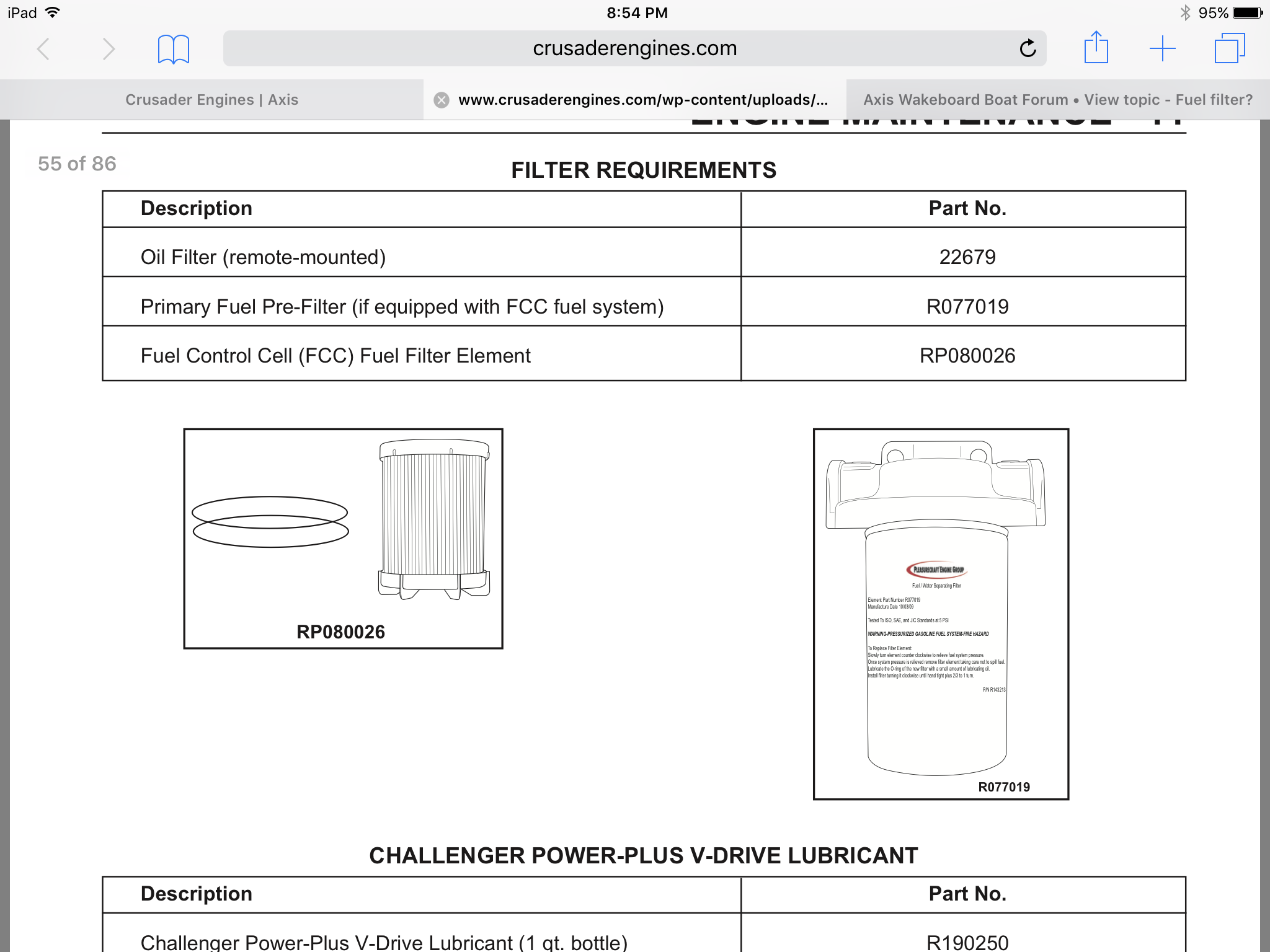

Just doing my 25 hour service and just so you don't use any wrong fluids be sure your using what the pcm manual reccomends, not the indmar link above
2017 Axis T23 Red/Charcol, dual axle trailer, heater, chilax seating, flipping captains seat, sound pack 2, surfgate, and wedge. 850 sumos rear 675 bow
 Post subject: Re: Changing the oil
PostPosted: Thu Sep 07, 2017 11:31 pm
Joined: Sat Aug 12, 2017 3:04 pm
Posts: 41
See picture for oil fter fuel filter etc

Your oil filter is a Napa Gold 1515, wix 51515, Royal Purple 30-8A or cross reference one of these.
