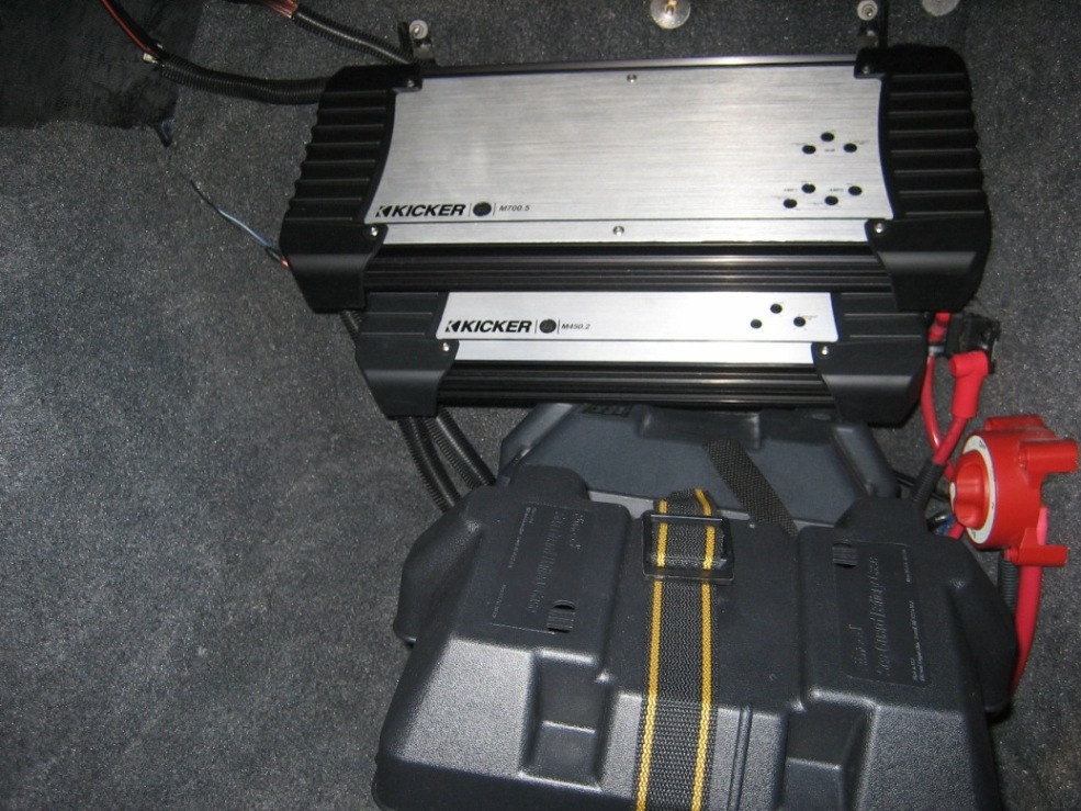

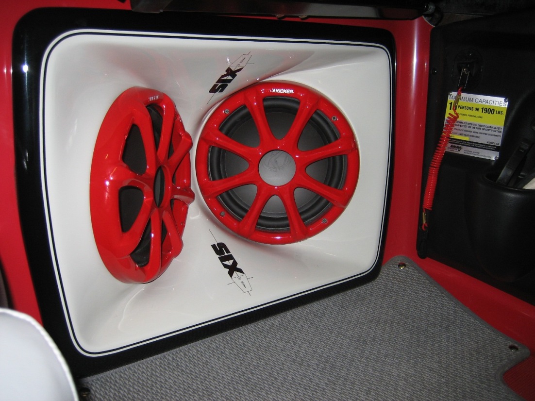

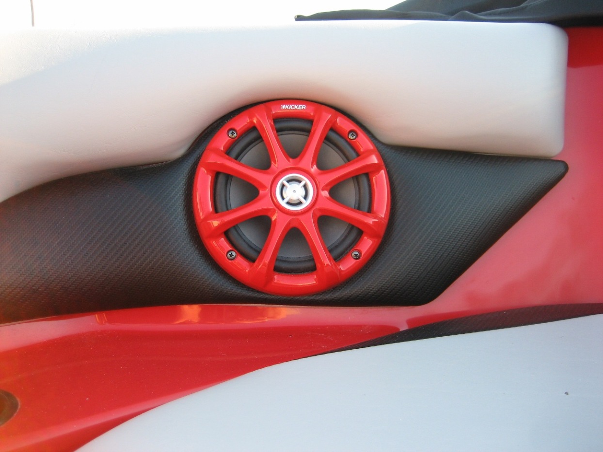

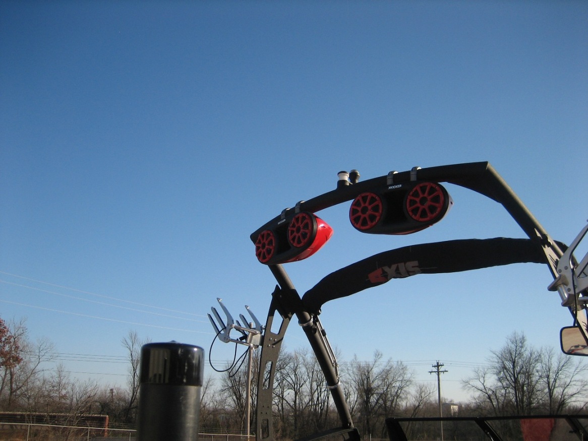

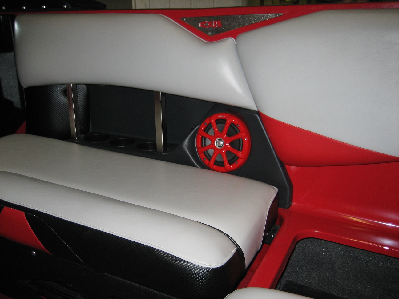

They are almost finished. A big thank you to 4N Motorsports (facebook.com/pages/4N-MOTORSPORTS/147927108251)!!!!

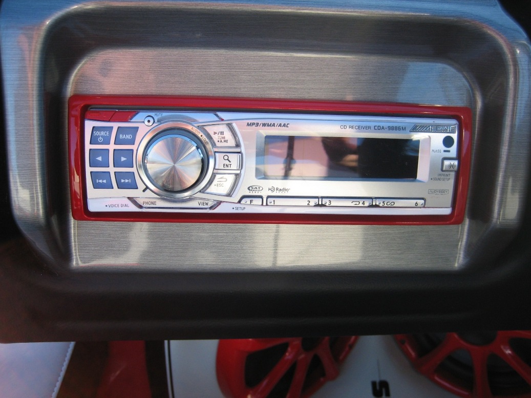

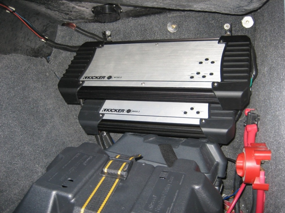

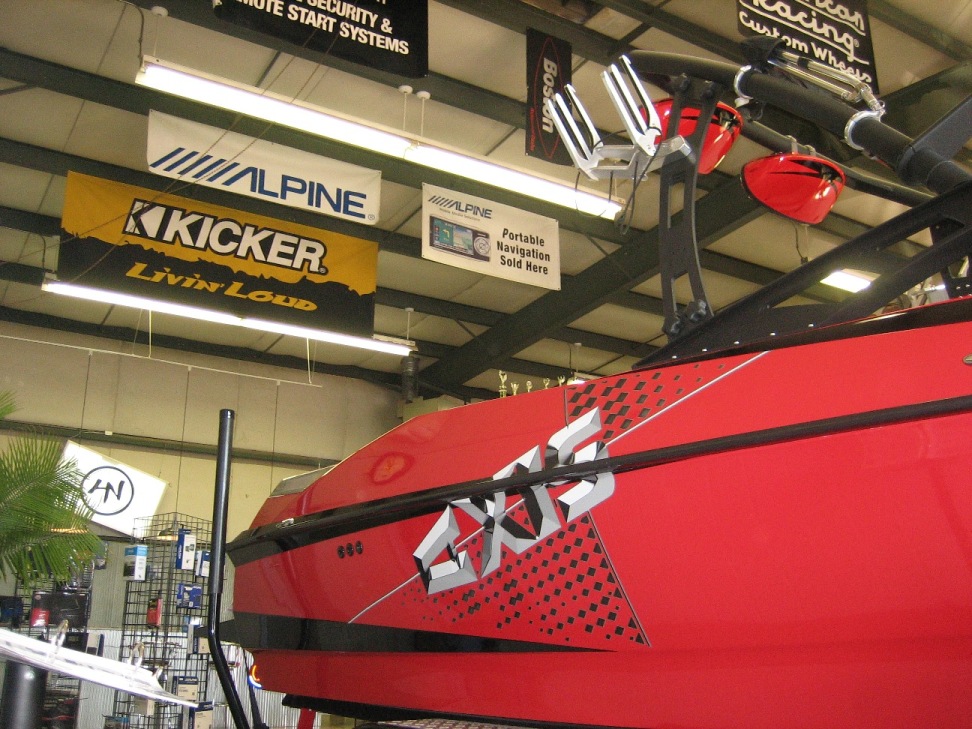

More pics,,,,

Wow!!! Nice job

I have so many car systems floating around and a few boats; however, this install in amazing. This is making me scratch my head to do more work. It looks very nice.

Very nice install. Looks good. Really nice job on the sub under the dash!!!!!!

Looks good! I'm curious how those subs will sound. 10's wired in parallel off the 700.5?

Kicker KM10's have 4ohm coils. 2 in parallel will drop the load to 2 ohms which I am sure you know. That 700.5 is a nasty amp for a 5 channel. I have run a solobaric on one. Its 2 ohm stable. I have been dealing with kicker for years now. The only time I see there subs blow is due to people not letting them cool down and they sieze up.

I'm sure that I am totally biased, but the boat sounds unbelievable. The two KM10's perform amazing. If you or anyone is in Southern Missouri or Northern Arkansas, please get in contact with me to hear the system. I am very very pleased.
