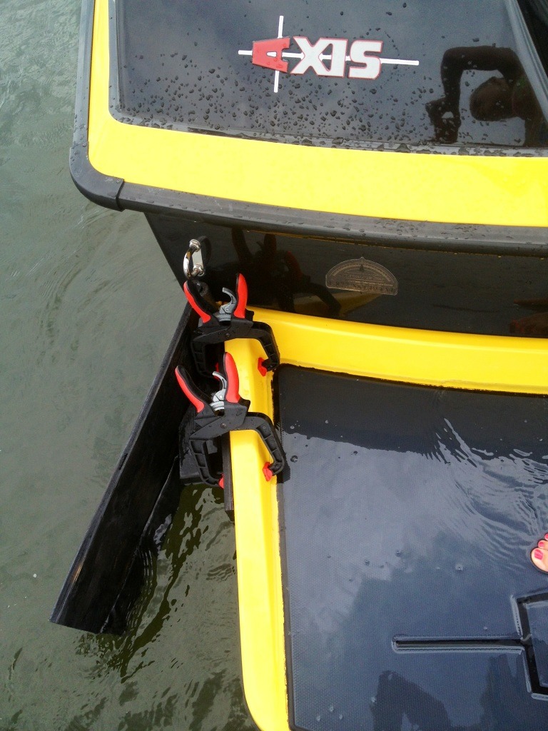

 Post subject: Re: Home made "Poor-gate"
PostPosted: Sun Aug 11, 2013 8:23 pm
Here's mine that I put together, it took about 15 min to throw together but was very effective.
PostPosted: Sun Aug 11, 2013 8:26 pm
It makes a great wave, I will get some videos posted when I get them off my gopro. Very Impressed with the results.
 Post subject: Re: Home made wave device
PostPosted: Sun Aug 11, 2013 9:39 pm
Posts: 276
So cool Gibbs!! Did u have yours seal up against the hull or keep it simple with a straight rectangle shaped tab?
