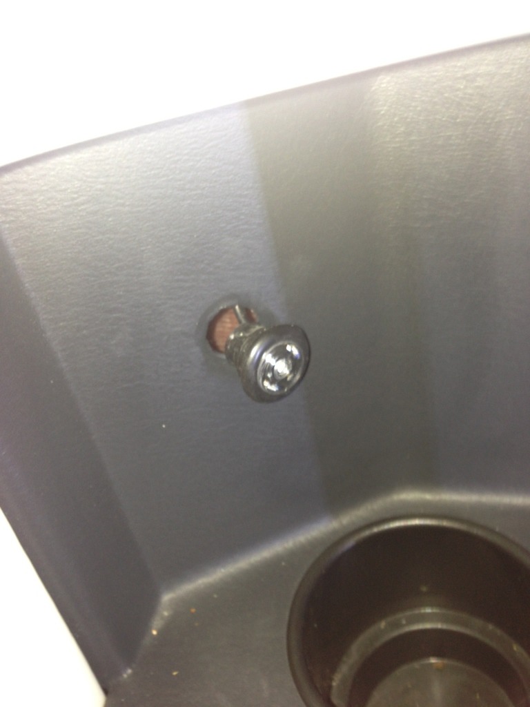

Here is a cheap easy way to turn your factory led light any color. So I went on EBay and found blue Transparent 3m tape since no auto parts store around me sold any. Then I pulled led out very carefully and when you do a rubber Garment comes out with it pull rubber Completely off
then wrap tap tightly around led you have to make small cuts so it goes over led and press firmly behind led then slid rubber Garment over led and when you do it will keep tape firmly in place over back side of led to keep it from pulling off on the edges.
If you have any question just let me know this tape is rated for temps over 100 degree but these led wont get that hot anyway. I will be adding more blue led lights when they come in mail I will upload more picks when done.

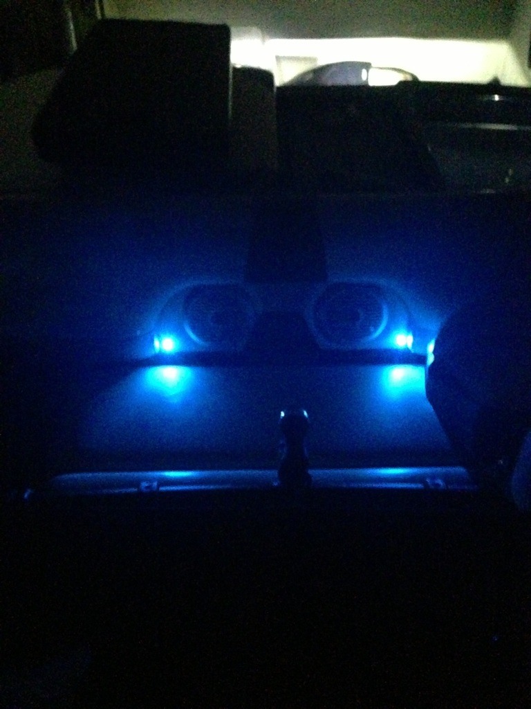

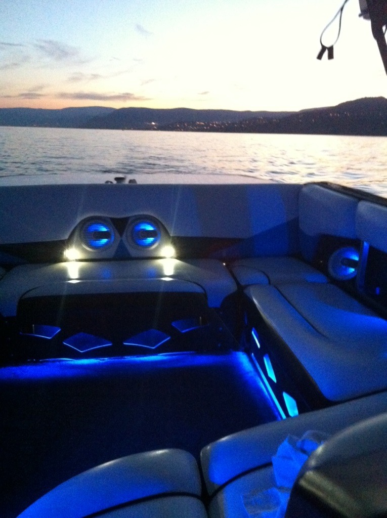

these are the blue led's I added to all my speakers and Also a few more under the seats
