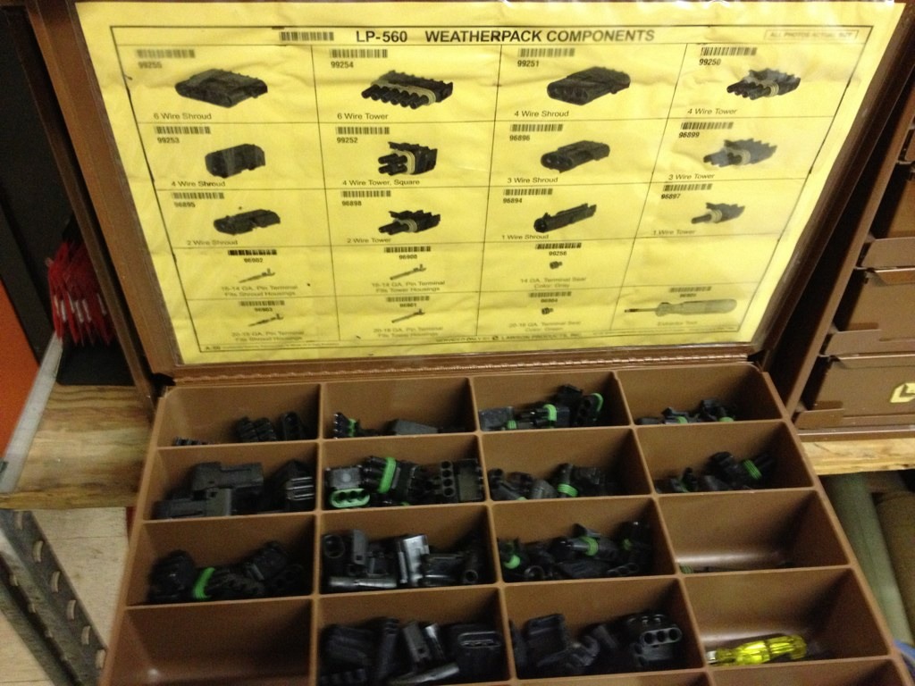

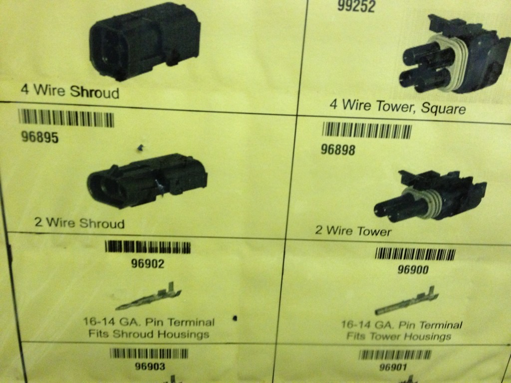

I have an assortment that I get from Lawson products, I'm not sure where else to look though, here is the part numbers for the towers and shrouds you will need, and also the pins

Thanks Walter - that's exactly the info I was needing. Knowing that they're called weatherpack made it easy to find some online sources.
