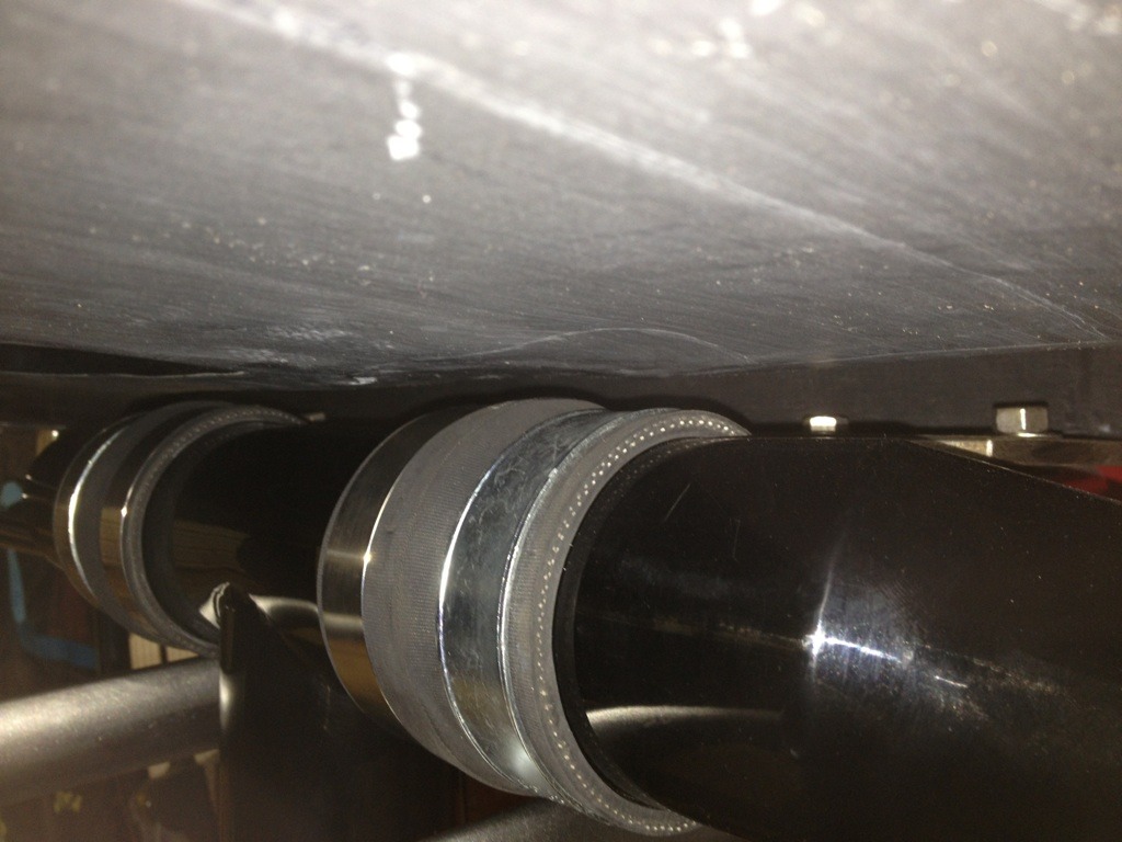

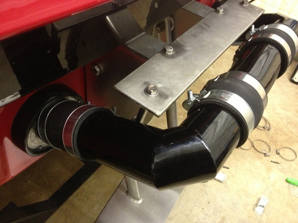

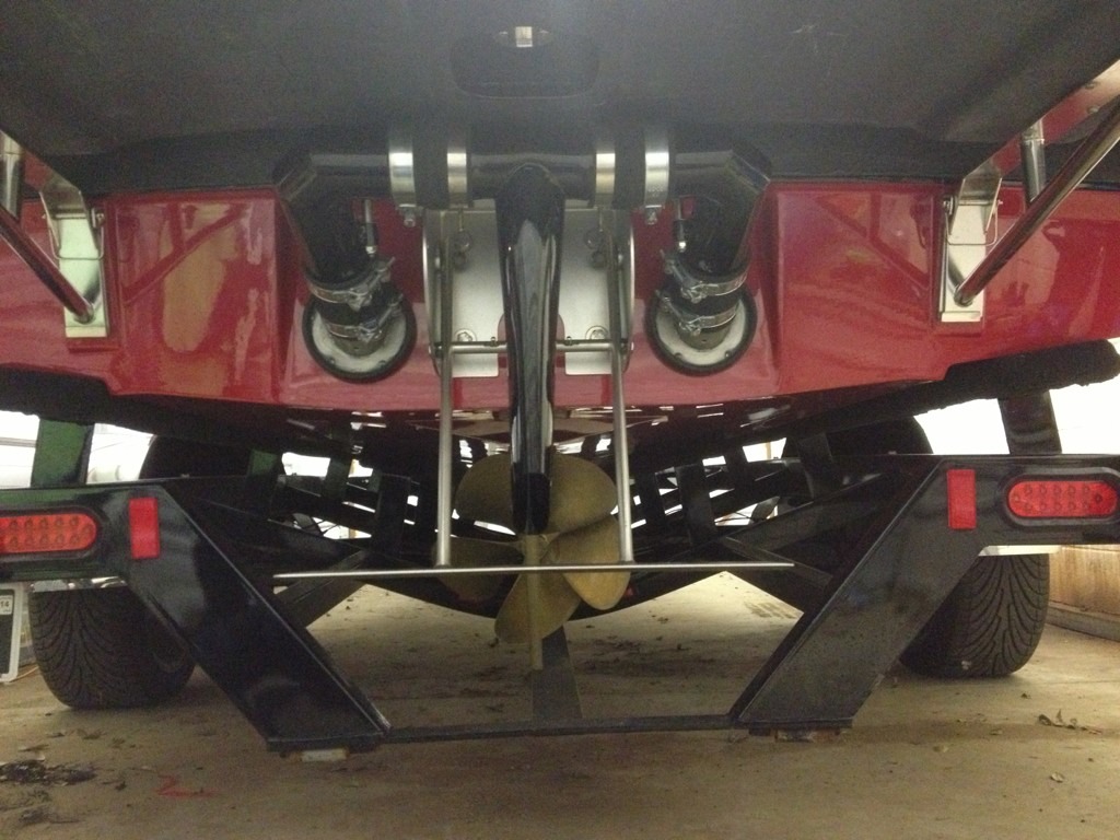

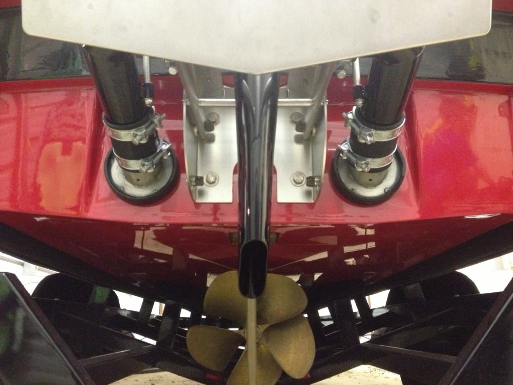

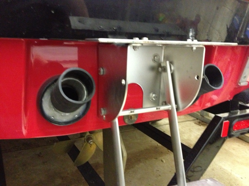

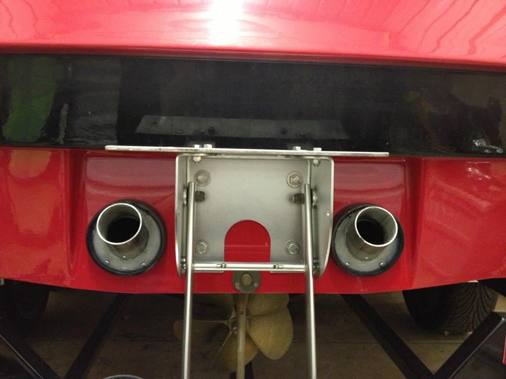

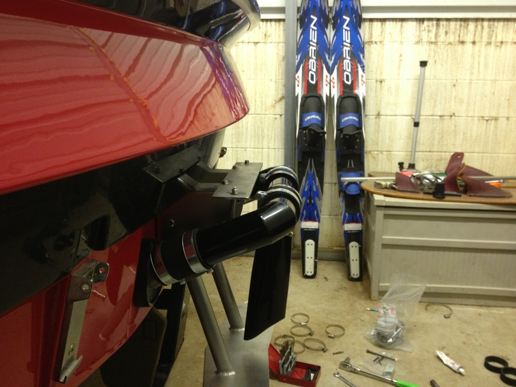

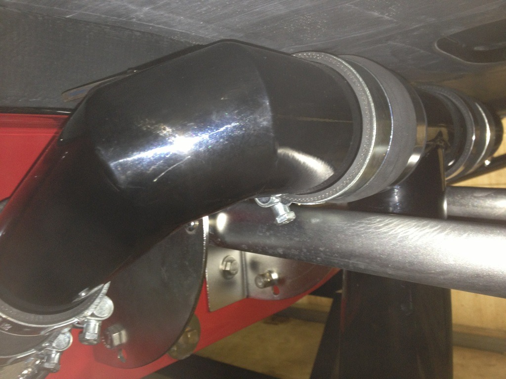

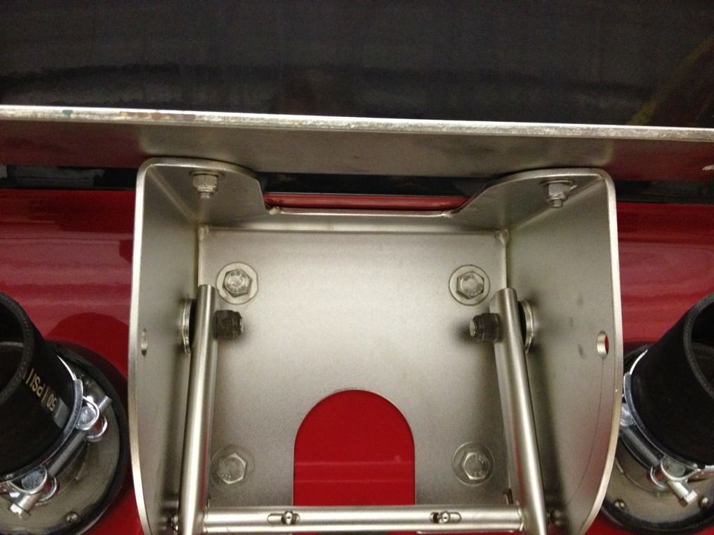

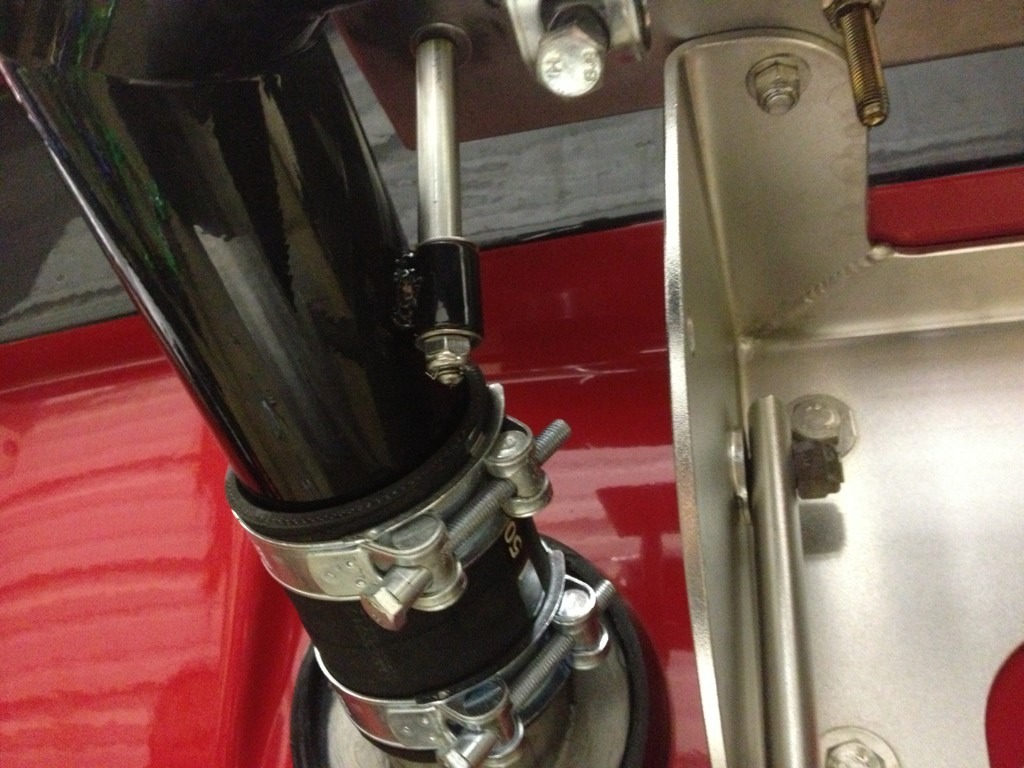

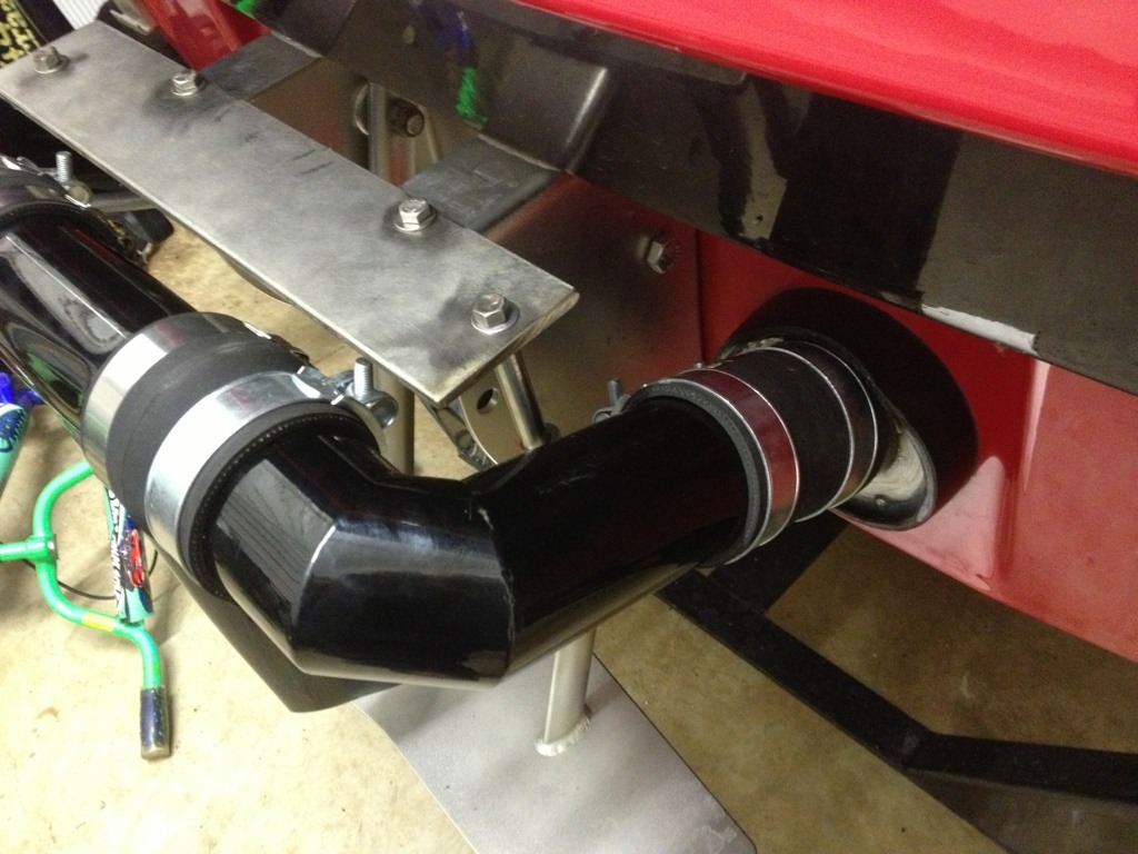

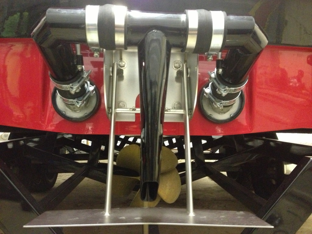

Just finished up installing Larry's redesigned FAE to fit with the wedge on the axis. I made my own support bracket to actually bolt to the wedge bracket, this thing is rock solid!! I can't wait to get it on the water and take a test run!!

He sent it with a stainless tubing and mounts to mount it to the swim platform but my platform has a little up and down play so I picked up a piece of 304 stainless and just mounted it to the wedge, drilling the holes was a major pain and burned up a few dozen bits but I think the finished product was worth the effort, best part is he said he would refund me the cost of the mount kit!! Super nice guy to work with.
