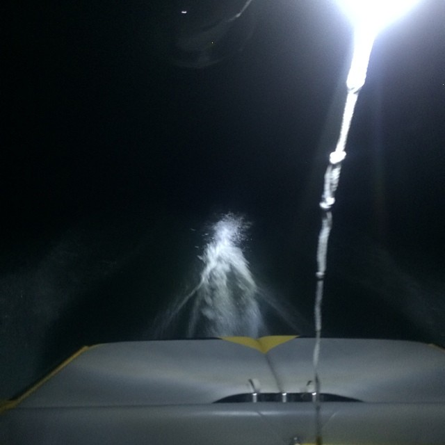

I just installed these Tuff Stuff Performance 10" Led- 12" Off Road Led Light Bar Flood/Spot Combo Beam- 3W Led-72W-4500 Lumen. . Got them off amazon fit perfectly and are really bright. They are the only light source in the second picture.

I installed mine by putting hose clamps around it and put some hot water heater tubing around it so it did not scratch the tower. I have a quick disconnect on the light using a 2 pin trailer harness so I can take it down or swap out if necessary. We put a switch after the on position of the underwaters and a relay from it to trigger the light. I can have underwaters on only or kick on tower light. I cannot run the tower light without underwater though. Here are some pics I means to post a while back. Sorry!
