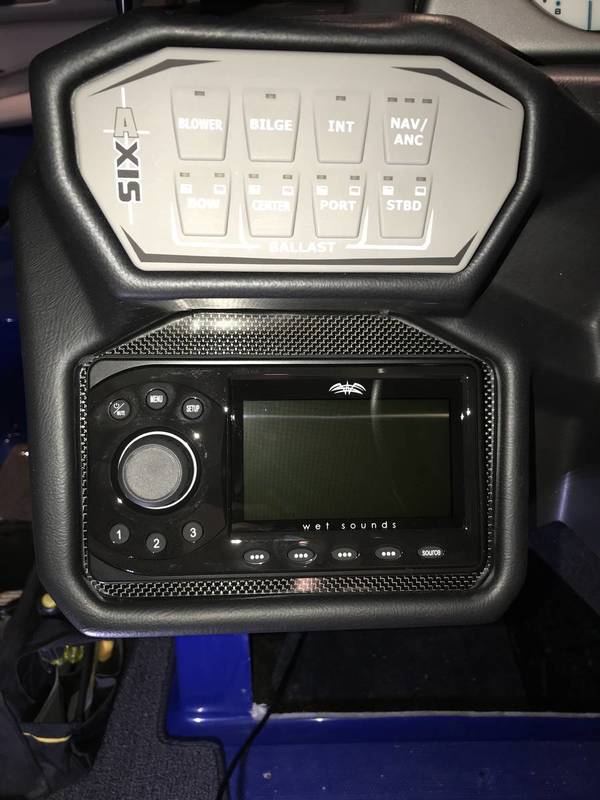

I just put the same unit in my 2017 A20. Fairly straight forward install but you do lose transfer beep and volume controls on surfband. Not a huge issue for me but Im still waiting on wetsounds to work out a solution. I heard they were in talks with axis about it. Its much better than the stock unit for sure.
