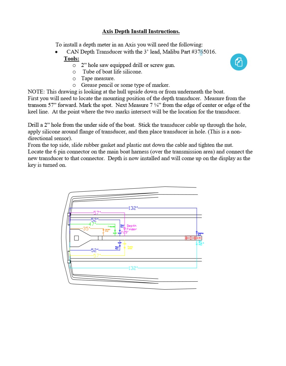

PostPosted: Mon Sep 21, 2020 5:36 pm
Joined: Sun Apr 22, 2018 8:42 pm
Posts: 13
Location: Annecy, France
Got install instructions from Axis in case anyone finds them useful
